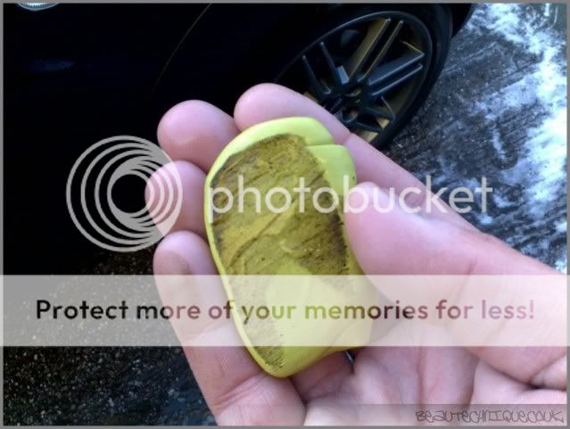

Rinsed off and then usual tar removal with Autosmart tardis, rinsed and clayed. Claying undertaken with yellow poly clay and Meguiars last touch spray detailer as lube. Contamination was heavy all over.

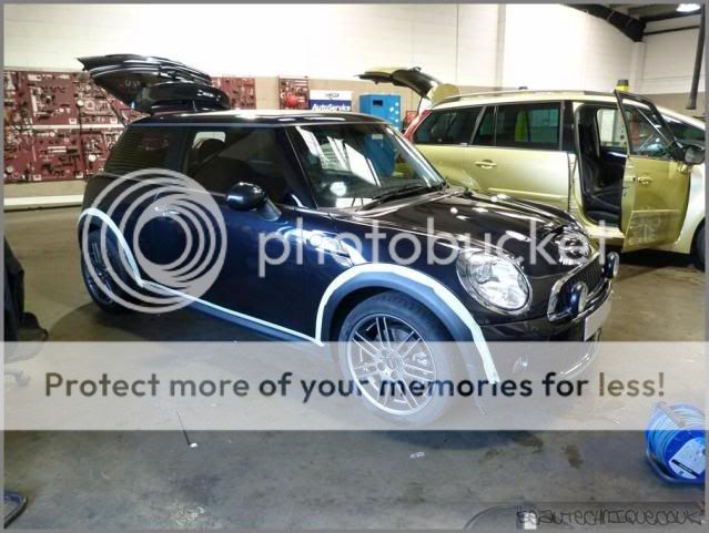

Dryed using Autosmart tango and Autosmart waffle towels and left for a few minutes with the unit heater on to dry the car ready for taping up. Taped up and reayd to roll...

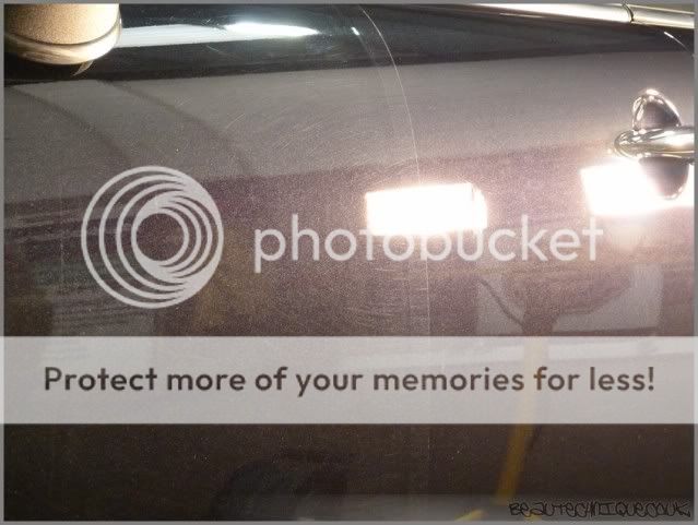

The level of defects was quite average and concidering the size of the car I felt a little extra tweek was in order so a single set all over with [b]Farecla wool pad and Scholl concepts S17+[/b] followed by Scholl concepts S17+ on 3M yellow polishing pad gave some great results...

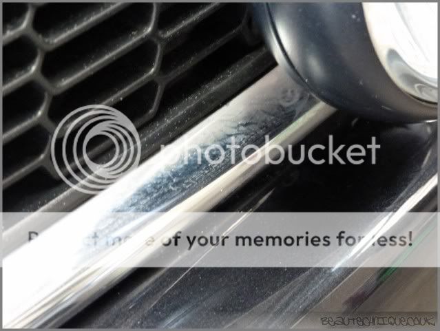

All metalwork was slightly tarnished so Britemax was on the cards and played a blinder.
Before...
And after...
