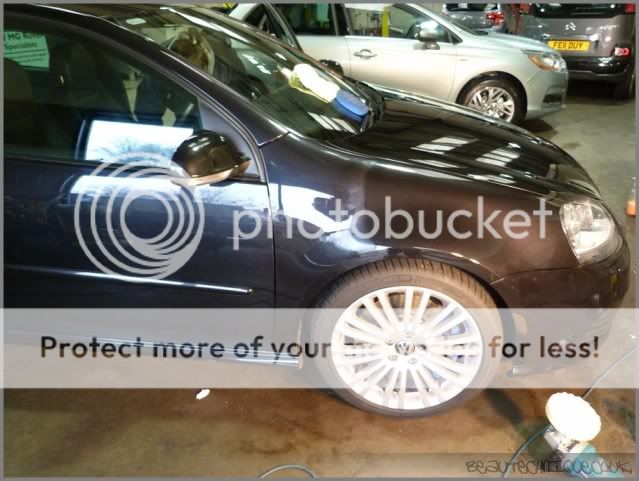

Time for tape and a little tester on combination for this little beauty. Straight in with my favourite combination 3M yellow polishing pad and Scholl concepts S17+. First hit was ok, second was better, third was like this...
Combination was a major thing as this was 1 day enhancement detail. The clocks ticking.
Bonnet after various hits with the afore mentioned combination...
Much nicer with some crisp reflections.
