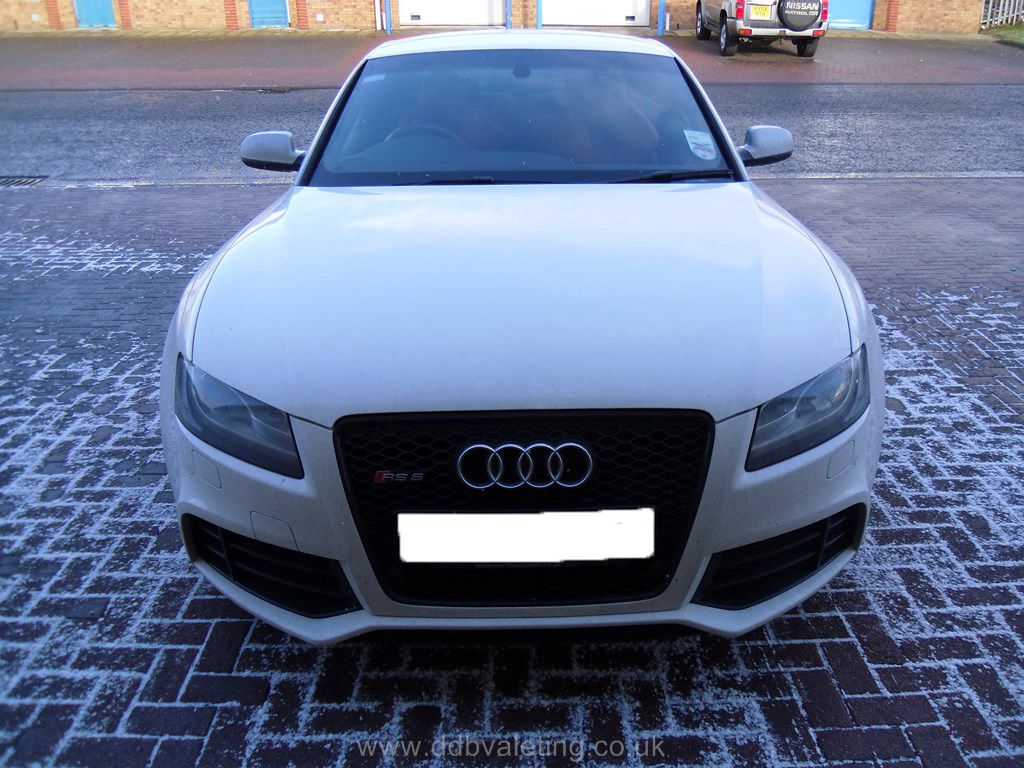

Before Shots
Usual safe wash processes carried out, wheels were done first, plenty to deal with as you can see. Hit first with a Non Acidic wheel cleaner and left to dwell for a few minutes. This was then blasted off and then the wheels were cleaned with a variety of brushes and more Acid free wheel cleaner, then treated to plenty of Car Pro Iron X to remove the stubborn build up of brake dust.
As I began the pre wash stages the snow started for real!! Lovely timing, snow foaming in the snow! Foam used was PH Neutral Cherry Snow Foam, then rinsed using PW to remove a good chunk of the muck on the car. Usual 2 bucket method wash then carried out using Gtechniq G Wash as shampoo.
Decontamination took a bit of time on this one, first off the fallout. Taken care of with more Iron X, and as you can see there was plenty of it to deal with.
Next up the tar removal, every car is covered in tar at the moment, this one treated with plenty AS Tardis to remove all the black spots on it.
Car was then clayed to remove all other bonded contaminants and then rinsed and dried and put into the unit for polishing and LSP.

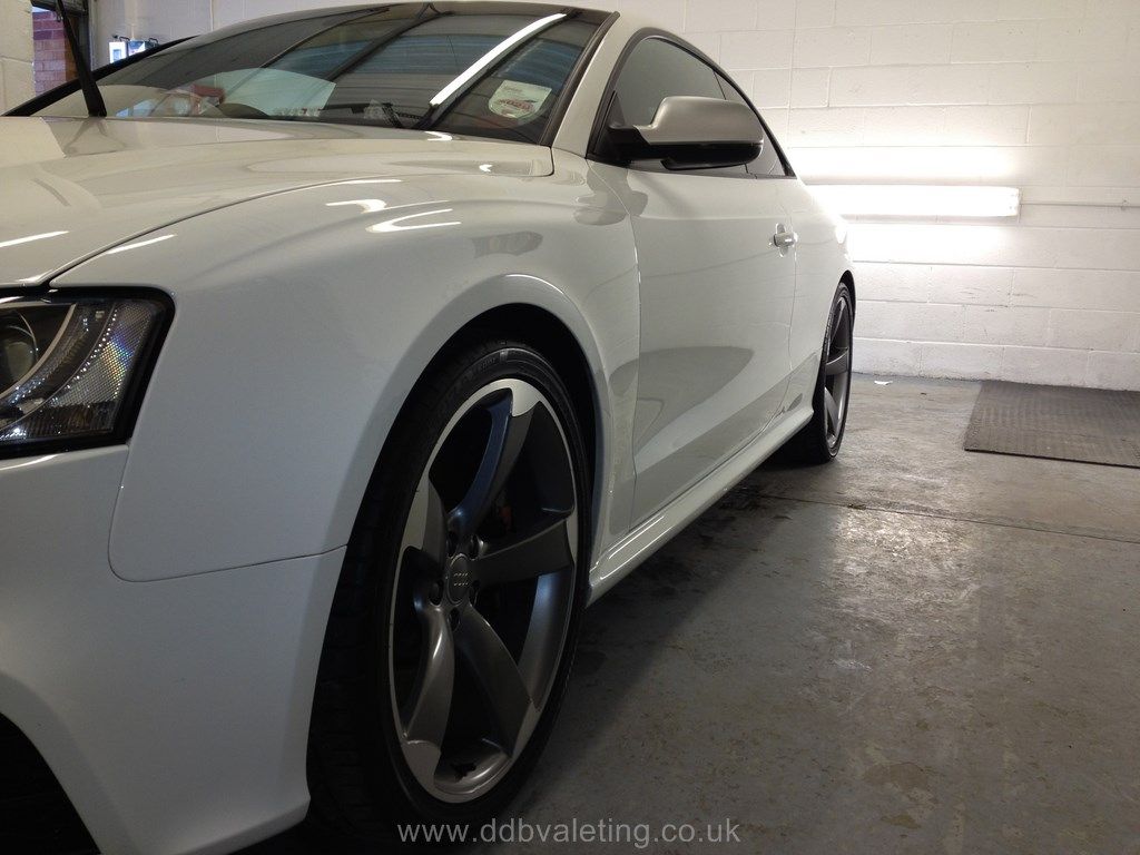

After pics.
[IMG]http://i147.photobucket.com/albums/r284/daviebsri/Audi%20RS5%20March%202013/SAM_4502Copy_zpsbd2922[IMG]
I am sure you will agree a massive turnaround on this one, and now a fully protected car to maintain. Another happy customer left the building grinning, after saying it was like having a brand new car again. If you got this far thanks for reading and see you next time.
